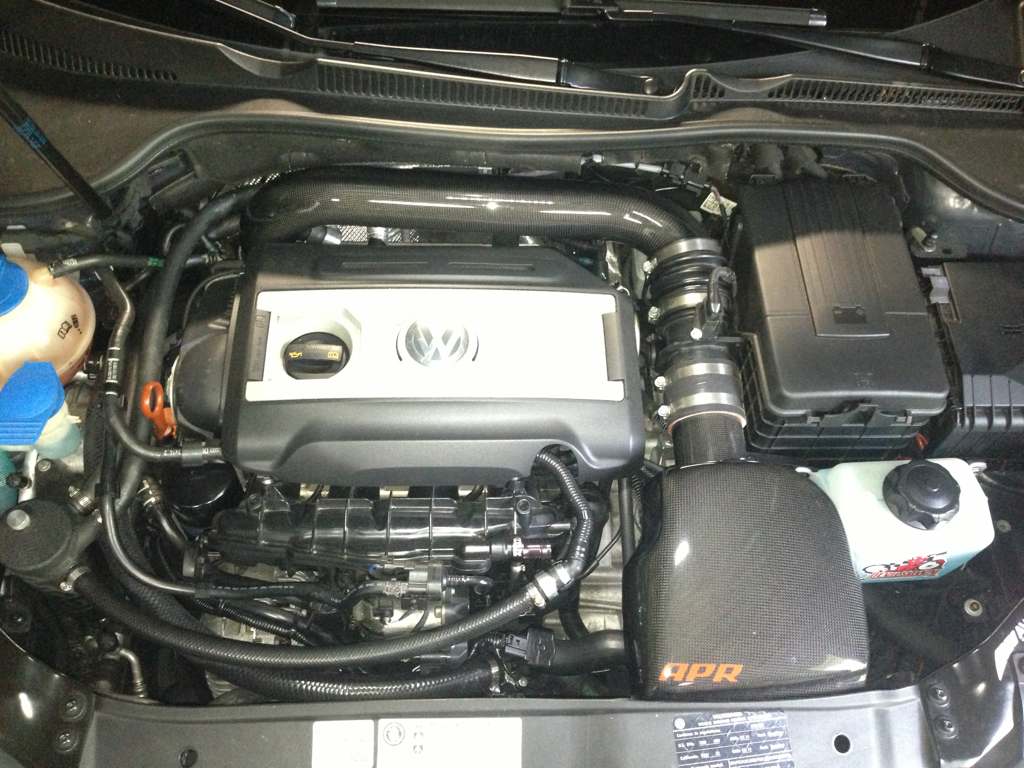

I'm using the R1 with a relocation kit I put together using the same basic set up as modshack, but with a few different parts to make it a bit cleaner and appealing to look at.
But the valve is great. Insanely quick is the most noticeable thing. If you have a boost guage you can see the before and after difference. So quick that you really can't hear it if you have and exhaust work done, because by the time you've let off throttle to shift and the engine noise drops, the valve has released and shut. So boost builds instantly. Much nicer throttle response. The car just seems to work much smoother in all types of driving. Especially around town. And it's maintenance free! :)
No complaints with it.
