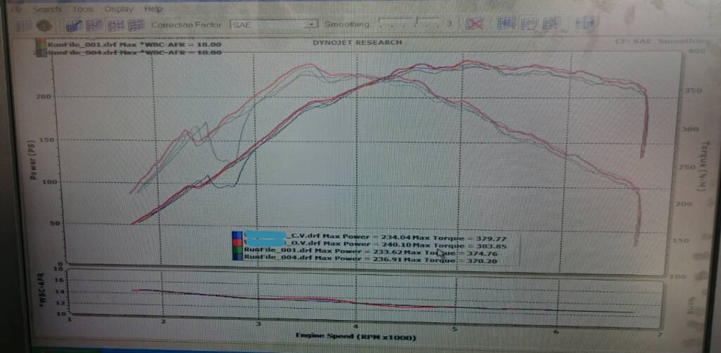

Ambient temp was around 31C at about 11am.
Mods: Apr stage 2 tune v2.1 Ron95 tune. (I have Ron95, Ron98, Valet and Stock tunes)
Hardware: CTS Turbo Intake stage 1 and 2 pipe, R8 Coilpacks, 3 inch downpipe w/o catalytic converter, full sized resonator, Valvetronic Exhaust
Fuel: BHP Infinity Ron97
Run 1: Close valve 233.62 hp/374.76 Nm
Run 2: Close valve 234.04 hp/379.77 Nm
Run 3: Open valve 240.10 hp/383.85 Nm
Run 4: Open valve 236.91 hp/370.20 Nm
These are all done consecutively one after the other.. I am guessing the 4th and final run, there was heatsoak and ECU retarded the last run.. That's why the big dip at ~2.5k rpm...
Anyone got any comments on this?
Dyno numbers look normal?
Guessing that the 15 to 20% losses from crank to wheel would make this a 280hp /450Nm crank power?
1st time doing Dyno to understand where I should be in the rev range when driving uphill and on highway drives...
Maybe next time, I will use the RON98 tune and with Petron Blaze RON100 to see what extra Hp/Nm I can get out of an open valve...

Hmmm.. Hopefully there isn't a boost leak.. Any idea how complicated it is to check if there's leak? Can it be low due to Carbon buildup? 62k km already..

So an update for everyone to comment and let me know...
Apparently there is a torque limiter (limited to 380Nm?? for the DSG Gearbox) and its suppose to be removed via a tune or flash.. I am not sure what that means because my ECU is already flashed/tune.. May be the DSG tune? but that shouldn't be the case right? Either way, I am getting the HPs but not the Torque...
So that's problem 1..
Problem 2 is there is something wrong with my 95 map.. There is a drop around the 2.7 to 3k rpm.. And i did some logs and showed heavily retardation on gears 3 and 4 for the degrees, sometimes it goes up to 6-7..
On 98 map, its smooth.. so hardware problems have been ruled out and all 3 dyno runs were on RON100 gas.
Anyone can chime in on my problems?

The DSG does limit torque you need to get a DSG tune to bypass that. That being said it isn't truly required but the Factory DSG does start limiting how much torque can go down right around 350Nm.
That being said 380Nm (or ~280ftlbs) is about on par with what i get on my Stratified Flash tune (equivalent stage 2)
I sit around 240whp and 280wtq.
APR dynos at the hub(no wheels on) so their numbers are always a little higher than realistic real world expectations imo.
As for the dip on 95 it could just be fuel quality or the map is just mehh... if you can keep using at least 98/100 as it plays nicer with your car while using the 98 tune.
I personally wouldn't be upset with those numbers. Those are pretty average stage 2 numbers.
