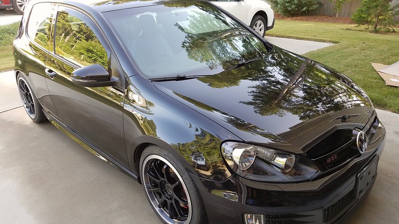

GoodTimesIndeed Build Thread...
GoodTimesIndeed
2011 Volkswagen GTI
Current mods completed on project "DEEPSLEPR"
Engine
  • K04 APR V3.1
  • Neuspeed fmic
  • Custom H20 intercooler sprayer
    - 2qt tank
    - Hypersonic spray nozzles (2)
    - Trico Pump
    - Coolingmist boost trigger
    - Solenoid
  • Custom Spectre intake with velocity stack and custom heat shield
  • Eurojet turboback exhaust (3" catless)
  • SnowPerformance water/meth injection system
    - Snow Performance VC-50 Controller
    - 375 ml/min Snow Performance nozzle (1)
    - Snow Performance check valve/holder combo (1)
    - Snow Performance Solenoid
    - Snow Performance Wastegate Solenoid
    - AEM 200 psi pump
    - AEM inline filter
    - Coolingmist 2+ gallon trunk mount tank
    - USRT Tuner's pump pressure gauge
  • 034Motorsports dogbone mount
  • 034Motorsports motor mount (street density)
  • 034Motorsports trans mount (street density)
  • HPA 75A lower puck mount
  • ECS Tuning catch can system
  • AWE turbo outlet pipe
  • BSH throttle body pipe with meth bung (and DEI Cool Tape heat wrap)
  • PTP K04 Turbo Blanket
  • PTP lava wrap on downpipe
  • Upgraded OEM DSG cooler (version C)
  • Billet aluminum DSG filter housing
  • 6.6 bar fuel filter
  • R8 coil packs
  • NGK BKR8EIX iridium IX spark plugs - .024 gap
Suspension
  • Neuspeed 25-mm front sway bar
  • Neuspeed 25-mm rear sway bar
  • Neuspeed rear sway bar endlinks
  • Spulen adjustable front sway bar endlinks
  • TyrolSport DeadSet rigid subframe collar kit
  • Stern 3-point lower rear brace
  • EuroSport upper rear X-brace
  • EuroSport upper front strut brace
  • TCR-II Chassis Brace System
    - Upper front strut brace
    - Lower front stress brace
    - Front tic-tac brace
    - Rear tic-tac brace
    - Rear lateral brace x2
  • Powerflex A.L.K.
  • Powerflex control arm bushings - Front position
  • Solo-Werks S1 coilovers
Brakes and Tires
  • TyrolSport caliper stiffening kit
  • TyrolSport Master Bracket
  • Centric slotted and drilled rotors (F & R)
  • StopTech street performance pads
  • StopTech stainless steel brake lines (F & R)
  • Custom front DIY brake ducts (Removed for now)
  • 56mm stud conversion
  • Summer setup - Enkei Tenjin wheels with Firestone Firehawk Indy500 tires
  • Winter setup - Sport Tuning T9 black wheels with Dunlop SP Winter Sport 4D tires
Interior
  • NewSouth center console pod
  • SpeedHut oil pressure and oil temp gauges w/customized faces
  • NewSouth redline boost gauge, and DIY inline filter
  • NewSouth steering column pod mount
  • Snow Performance VC-50 controller in ECS Tuning angled vent pod
  • AEM flow/warning - green LED
  • Direct-port spray - yellow LED
  • Intercooler spray - blue LED (center console)
  • Intercooler spray - master on/off switch (center console)
  • PolarFIS+ Advanced
  • Shift-I (SGAR) progressive shift light
  • 6-Drive throttle booster
  • DSG paddle extensions
  • 2 din Kaichuang KC-V001W headunit/FAKRA antenna/iPod cable
  • Rear backup camera (in rear plate light)
  • Car DVR camera recorder w/hardwire adapter
  • Aesthetic Creations blank button stickers (Marbles, Oil Slick)
  • Hidden master switch for w/m setup (in armrest console)
  • Manual look DSG shifter boot
  • Black Forest Industries DSG shift knob
  • "GTI" door handle inserts
  • "GTI" seat ratchet inserts
  • "GTI" headrest pillows
  • Dash cubby
  • Driver and passenger side under-seat trays
  • Seat crevice storage pouches
  • Broadway Mirror - 300mm convex face
  • Visor "air bag warning" removed
  • Keyhole decorative ring - German flag
  • Red pinstripe on dash and doors
  • Non-slip front door mat inserts
  • Automatic headlight conversion
  • White interior LED bulbs
  • Red footwell lighting
  • Monster Mats
  • deAutoKey LED trunk strip
  • WeatherTech trunk liner
  • H3R Performance MaxOut Fire Extinguisher
  • Clear protective film on lower door sill to prevent scratches
Exterior
  • Euro sport mesh front grill (paint matched) w/red GTI badge
  • WeatherTech dark smoked rain guards
  • LED door warning light w/VW logo projector
  • Smoked sequential LED signals with puddle lamp
  • Wide angle blue glass side mirrors w/LED arrow turn signal lights
  • OEM rear rubber bumper pad
  • .:R replica side skirts
  • Smoked side markers
  • "GTI" side badge(s)
  • DIY front lip spoiler
  • R32 Belly Pan Kit
  • SS hardware (underhood)
  • Nokya H8 yellow fog bulbs
  • Nokya Cosmic White Stage2 headlight bulbs
  • R20 style LED tail lights (dark cherry red/smoke markers)
  • Klii gloss black rear VW badge insert
  • VW Motorsport valve stem caps
  • GolfMK6.com, VW Minion, Steel City Euros stickers
VAG-COM
  • ESP defeat
  • Gauge sweep
  • Windows up/down with fob
Future Mods...
Engine
  • DSG Tune - APR (maybe)
  • LSD (maybe, especially if rear main seal needs replaced)
Suspension
  • Powerflex rear bushings (where needed)
Interior
  • Repair headliner
Exterior
  • deAutoKey Slim Digital H7 HID Headlight Kit
  • Possibly cosmetic pieces like spoiler, diffuser, etc...
  • Not add anymore dings or scratches!
Photos of things can be seen here.
I'm always doing things, changing things, or adding things so check back from time-to-time.
Please feel free to leave comments or ask questions. Always willing to help out.
Thanks for looking! 👍
