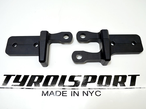

TyrolSport Hatch Brace Product Description:
The VW/Audi MK5/MK6 chassis, like other hatchbacks prior, experience a large amount of chassis flex during cornering. This chassis flex negatively affects vehicle handling. The TyrolSport Hatch Brace solves this issue by locking the hatchback hard points together with a revolutionary system of billet aluminum clamps and specifically designed rigid bars.

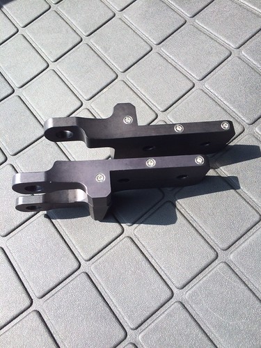

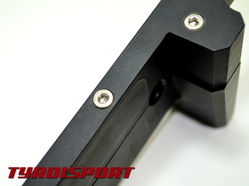

The TyrolSport Hatch Brace uses side-specific mounts precision-machined from 6061-T6 billet aluminum, with an innovative design that clamps around the rear seat latch hooks. These special mounts require absolutely no drilling of the vehicle chassis, and do not interfere with rear seat movement or locking. The full interior is maintained even with the installation of the TyrolSport Hatch Brace, with only minimal trimming required to the rear quarter plastic trim. These features are unique to the marketplace. Installation is a breeze, requires little technical experience, and can be easily accomplished in less than 30 minutes by an enthusiast. The bar can be removed in less than five minutes if a user needs to utilize the full space of their hatch, another feature unique to the marketplace.
The TyrolSport Hatch Brace comes in two forms; Stage 1, and Stage 2. Stage 1 is for street enthusiasts who want better handling and chassis stiffness. Stage 2 adds an additional triangulating bar for maximum stiffness. Stage 2 is designed for enthusiasts who may AutoX or attend HPDE events but can still be appreciated by street enthusiasts.
Within the two forms, Aluminum or Carbon Fiber versions can be chosen. The Aluminum bar is made from high grade 6061-T6 swaged aluminum tubing. The Carbon Fiber bar is an Ultra High Strength bar sourced from California. Both bars are connected to the side-specific, black anodized precision-machined 6061-T6 aluminum hatch brace mounts with PTFE lined 7075 Aluminum spherical bearing rod ends and stainless steel fasteners. All of the materials used for the TyrolSport Hatch Brace are the best available. While both options excel at stiffening the chassis, users who want the ultimate in light weight and strength should choose the Carbon Fiber bar option.
Carbon Fiber Bar Options:
Stage 1- (2) side-specific 6061-T6 billet aluminum mounts, (1) Carbon fiber hatch bar with (2) 7075 Aluminum spherical bearing rod ends
Stage 2- (2) side-specific 6061-T6 billet aluminum mounts, (1) lower 6061-T6 billet aluminum mount (2) Carbon fiber hatch bars with (4) 7075 Aluminum spherical bearing rod ends
Aluminum Bar Options:
Stage 1- (2) side-specific 6061-T6 billet aluminum mounts, (1) 6061-T6 Aluminum hatch bar with (2) 7075 Aluminum spherical bearing rod ends
Stage 2- (2) side-specific 6061-T6 billet aluminum mounts, (1) lower 6061-T6 billet aluminum mount (2) 6061-T6 Aluminum hatch bars (4) 7075 Aluminum spherical bearing rod ends
TyrolSport Hatch Brace Specs:
Side-specific, black anodized precision-machined 6061-T6 aluminum hatch brace mounts
High strength custom molded full Carbon Fiber bar, with threaded 6061 aluminum end caps

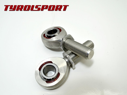

Custom 7075 Aluminum, PTFE lined, spherical bearing rod ends
18-8 Stainless steel fasteners
All brace installation hardware and ball hex drive T-handle included
Available in multiple combinations for added rigidity
30 minute installation – no drilling required
Less than 3 lbs

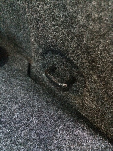

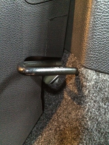

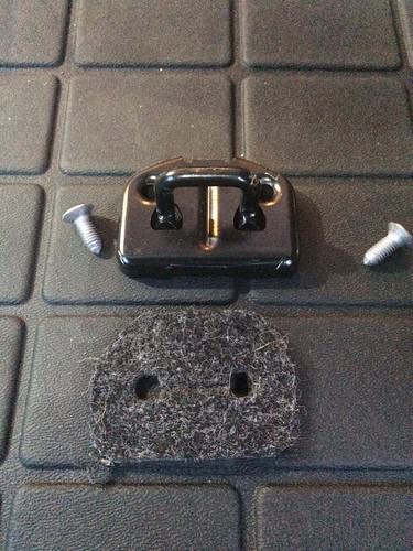

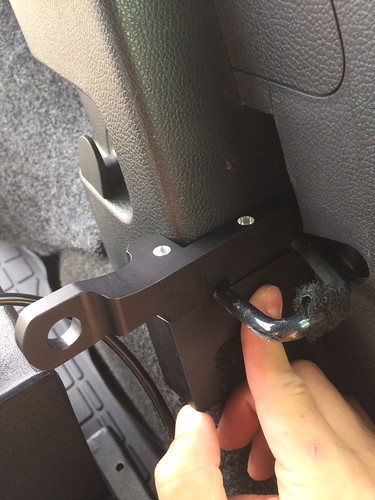

When considering the price of this TyrolSport Hatch Brace kit, I factored in the cost I would have paid a shop to professionally remove panels, measure, drill holes and install nutserts for an alternate hatch brace on the market. In all honesty, after reading reviews and DIY threads on the alternate hatch braces, the installations scared the hell out of me with correct measurements, nutserts, permanent holes from drilling, longer install times and the removal process for full trunk availability. Installation of the TyrolSport Hatch Brace truly is as advertised, 30 minutes or less. Since installing this TyrolSport Hatch Brace, TyrolSport has released their full installation video which may have saved me even more time. Considering the fun DIY approach and avoiding shop labor costs, the TyrolSport Hatch Brace options and pricing seem more in-line with other hatch brace options on the market. Below are the installation steps I documented to show how quickly the TyrolSport Hatch Brace can be installed (or removed).

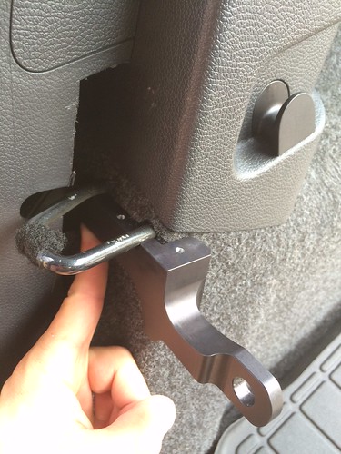

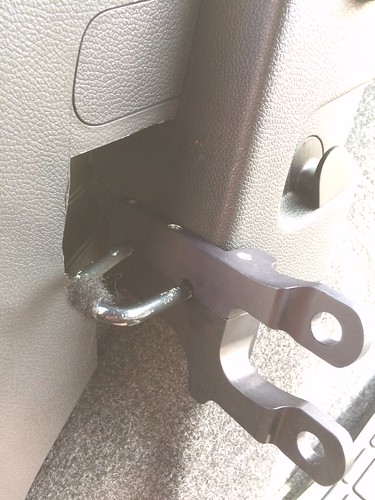

The first step for me was to toss the baby seats and fold down the rear seats. From there you can see the rear seat latch hooks which the side-specific, black anodized precision-machined 6061-T6 aluminum hatch brace mounts will clamp over when installed. Before seeing the TyrolSport installation video, I decided to trim a good amount of the plastic molding for the easiest access to tighten all of the allen screws. Less of the plastic molding can be removed for installation and with the seats closed, this area is covered so the trimmed area is not visible.
Align the two halves of the hatch brace mounts with pre-loaded screws.
Tighten the screws down little by little to tighten the two halves of the hatch brace mounts evenly until they are hand tight.

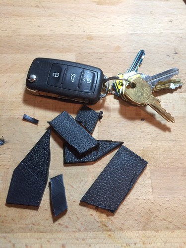

For the lower Stage 2 bar mount, use a razor blade to trim the indented shape of the carpet to gain access to the T30 torque screws.
Remove both screws and the anchor.
Reinstall the lower Stage 2 bar mount with supplied allen key screws, tighten until hand tight.

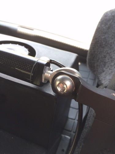

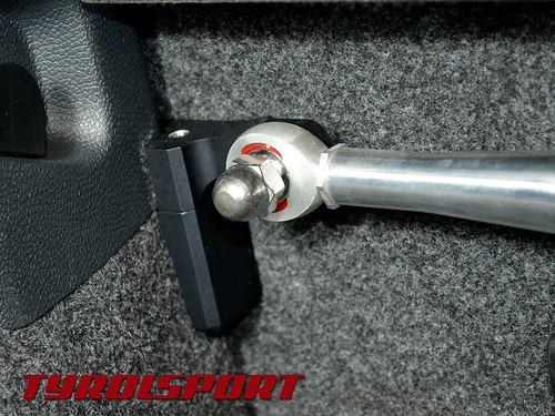

To install the Stage 1 bar, extend the Custom 7075 Aluminum, PTFE lined, spherical bearing rod ends until the holes line up with the hatch brace mounts. Use the supplied stainless steel fasteners (nuts and bolts), tighten until hand tight. Once installed, rotate the Stage 1 bar to shorten any slack, tighten until hand tight and hand tighten the jam nuts on the rod ends.
Stage 1 bar fully installed, seat down, seat up.

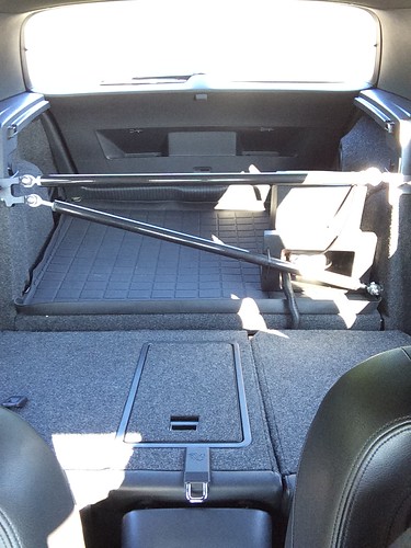

To install the Stage 2 bar, extend the Custom 7075 Aluminum, PTFE lined, spherical bearing rod ends until the holes line up with the hatch brace mounts. Use the supplied stainless steel fasteners (nuts and bolts), tighten until hand tight. Once installed, rotate the Stage 2 bar to shorten any slack, tighten until hand tight and hand tighten the jam nuts on the rod ends. Don’t mind the zip tie, it was to temporarily hold my water meth tank.
Stage 1 and Stage 2 bar fully installed, rear view, inside view.

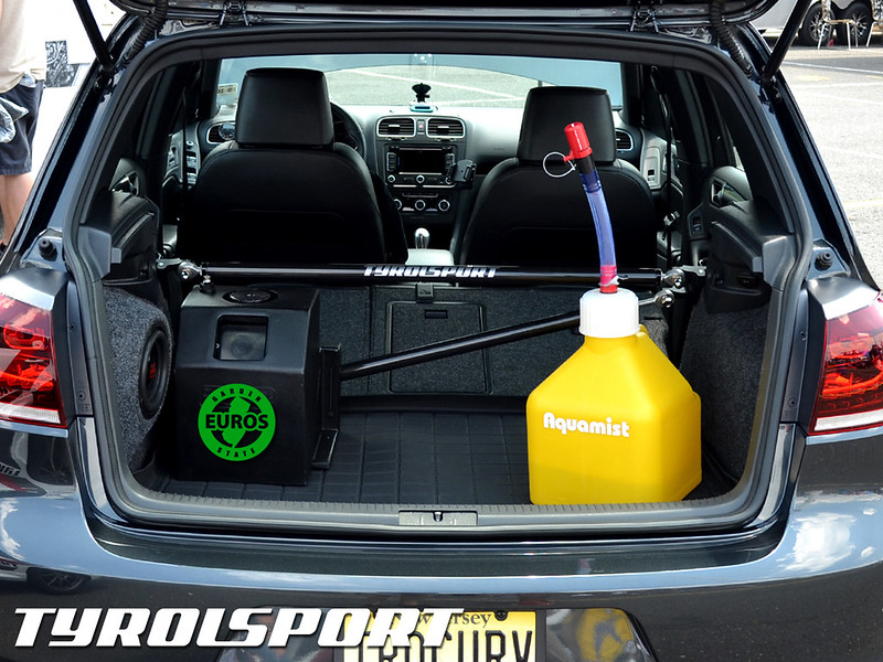

-Stage 1 bar maintains pass-through cargo space for larger items (wheels, tires, coolers, boxes, etc.)
-Stage 2 bar still maintains smaller pass-through cargo space for most items (golf clubs, fold up tent, camping chairs, etc.)
