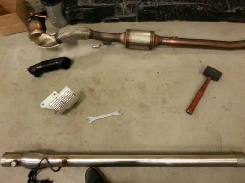

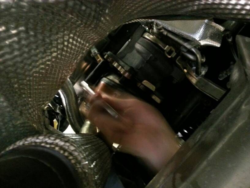

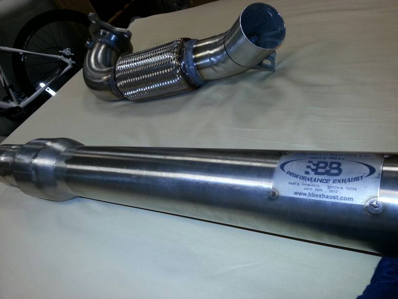

Installed my Billy Boat Downpipe the other day!! Here are a few pictures... didn't take much since we were crushed for time. The only access I have to a garage/safe area to work I have to pay for. Buts it worth it. We were able to get our hands on a lift.

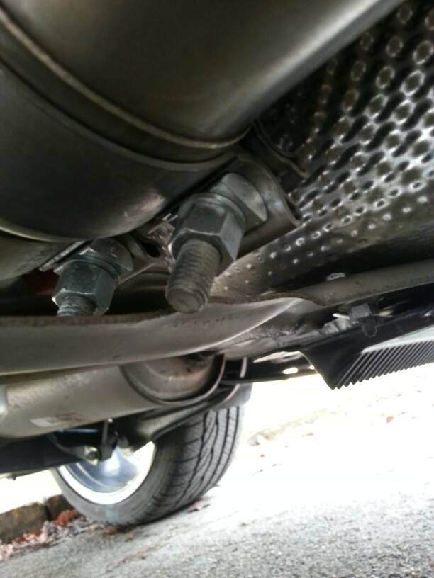

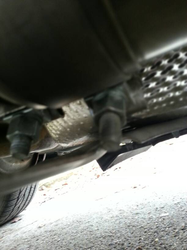

Soooo.. after installed and driving home I heard some rattling/grinding. You could say my stomach turned a bit. It was late and the auto skills center closed as we were leaving... (technically we kept them there 15 mins late....) so after finally getting back under my car I saw this...

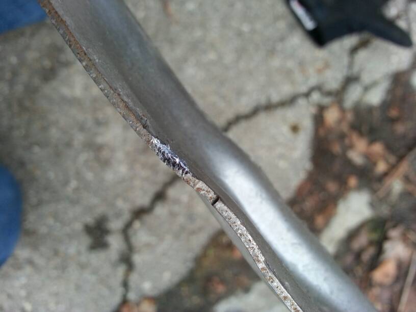

FML I see now that I had tighten the clamp bolts back to where they would touch cross brace. But you could say I was relieved that this is most likely the problem and not something serious. After removing the brace, it was confirmed.
That's the part that was touching the bolt. Anyways. Loosened the bolt and twisted it out of way, and I also turned the brace around so the indent part of it was facing the rear giving more space to the bolts.... just in case I guess. Drove the car.... no more grinding!!! Weeee... video coming soon if billy boat with stock cat back sound. Nothing too special in sound, but I can feel he difference for sure.

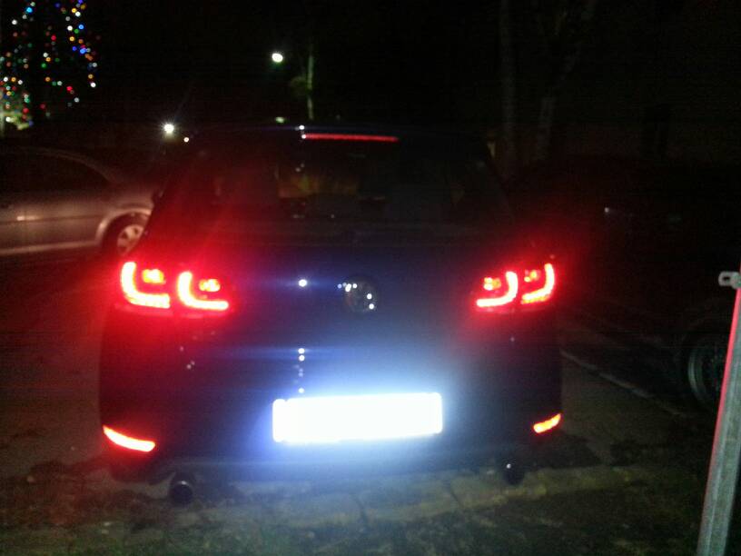

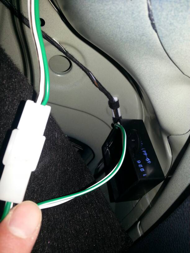

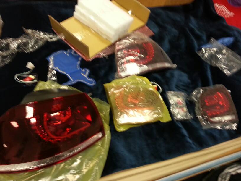

Nope... depo. Fitment is pretty good. Though I'm either going to go without boxes and code, since I have a cable... Or resecure them with Velcro... I don't think the double side tap works very well.

where are you supposed to mount them? I am going to help a neighbor with his DEPO's either tonight or tomorrow. If hidden, you could just use some model glue if its going on plastic.
Noob_2.0T
That's where I mounted mine. But I think they may have fell already lol. Does cold make adhesive less adhesive? It was pretty cold today and the double sided tape didn't seem to be in tip top shape... I have some Velcro that I think I'm going to use... Busy weekend so I'll give it a go this week. The inner lights I just mounted them in the space above (...when the hatch is up.. Really its in the 'below' space if the hatch were down...)..
