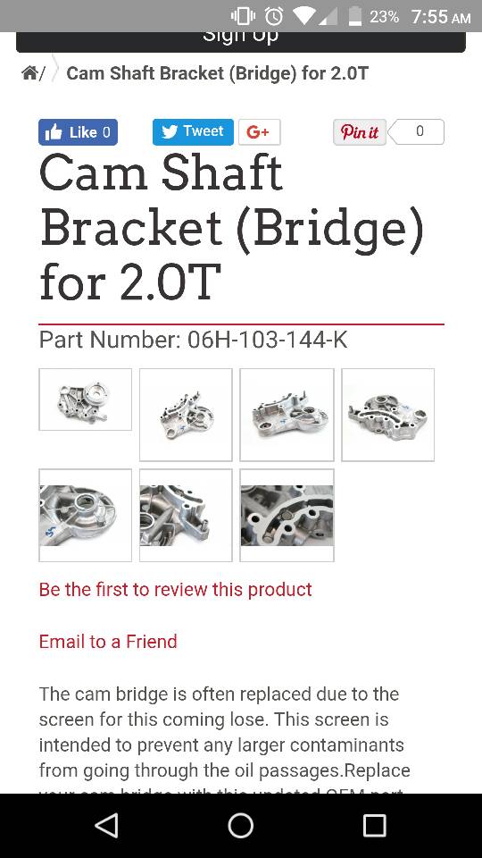

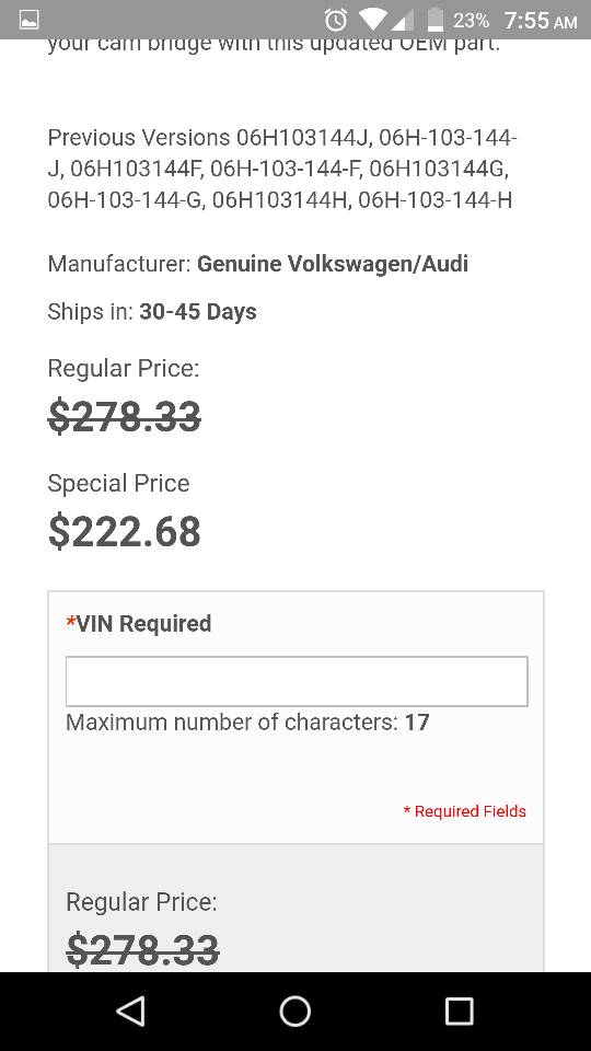

Yea, for the hell of it I just went on ECS Tuning to look up how much the parts cost. ECS Tuning's Cam bridge was a bit more expensive but for the cam bridge, upper timing chain kit (which includes new bolts, silicon, and cover), and oil/filter it came out to be around $675 in parts. I'm all for doing my own work when I can but this job was over my head and I didn't want to ruin anything.

Yea, going into this I thought it would be an $800 job. But I also had no clue about the cam bridge and its screen that likes to break. It might have been closer to 800 if it was just the tensioner swap. Really didn't wanna be spending that amount of cash but like I said before... beats turning your valves into mashed potatoes and being left with a bill for that.
