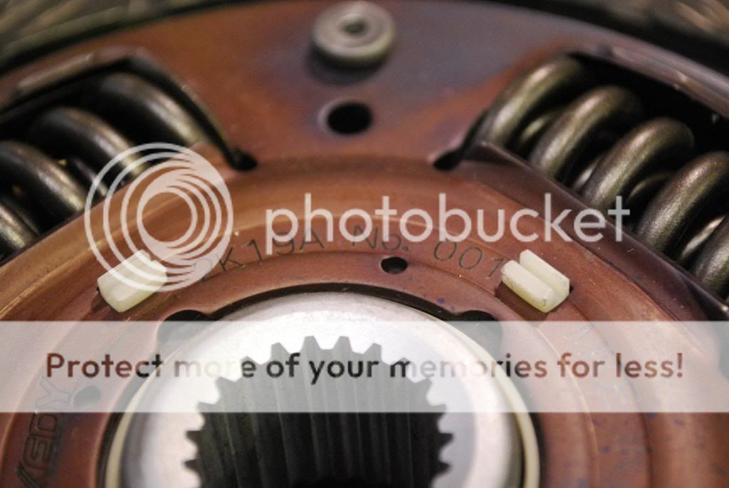

When we got the box back from Southbend, we immediately opened it to check out the clutch and compare. We were extremely excited to see the new hub design, it looks like an incredibly well built disc. You can see here that they switched the six-spring hub for a four-spring design.

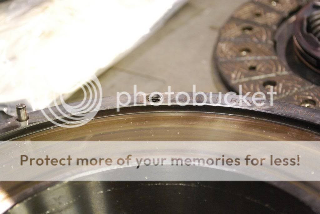

We didn't have the chance to measure the diameter of the disc, but Southbend told us the diameter is slightly greater and required opening up the lip on the flywheel very slightly:
Here is a shot of the other side of the hub:
