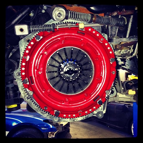

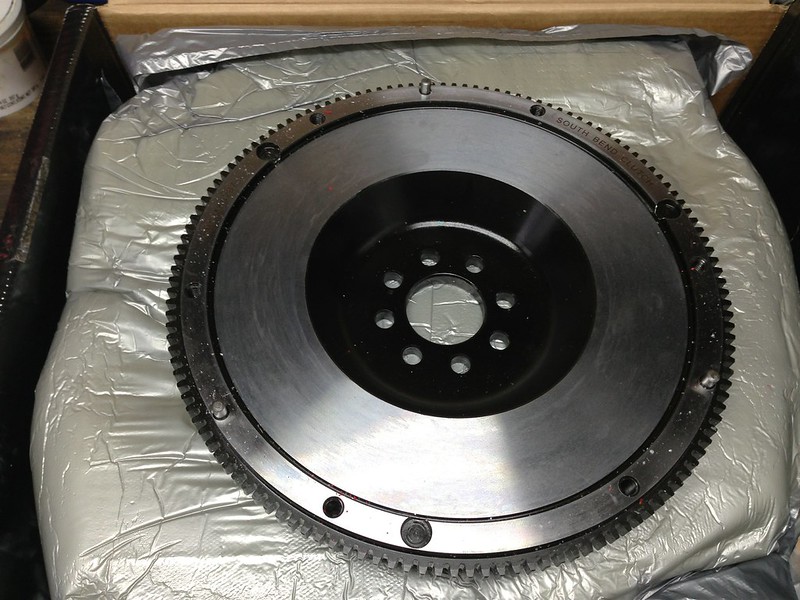

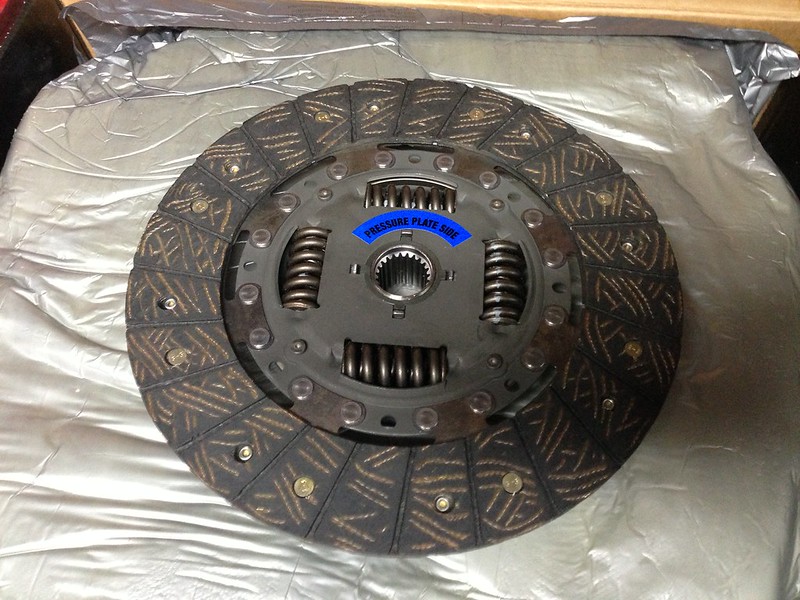

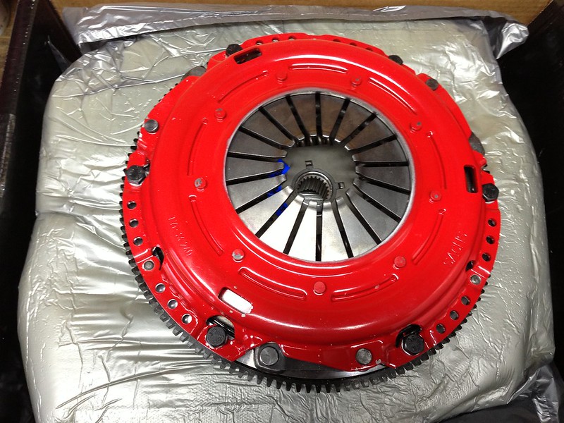

IMG_2046 by mustache rash, on Flickr
IMG_2051 by mustache rash, on Flickr
IMG_2054 by mustache rash, on Flickr
IMG_2092 by mustache rash, on Flickr
IMG_2091 by mustache rash, on Flickr
IMG_2166 by mustache rash, on Flickr

How is the clutch feel (weight & catch point)? How is the lightened flywheel, do you notice a difference?

The weight was VERY heavy at first. I hated it. After around 300 miles it softened up alot. At around 500 miles I would say it became about 10% or less stiffer then stock. Really nice feel
The catch point is identical to stock as I remember. Its sort of in the middle of the peddle range.
Take off is as smooth as stock since it is organic....

Dave do you have any pics of the stage 2 endurance disc & what kind of material does it use
mustache rash
It uses sintered iron on the flywheel side and organic on the pp side
