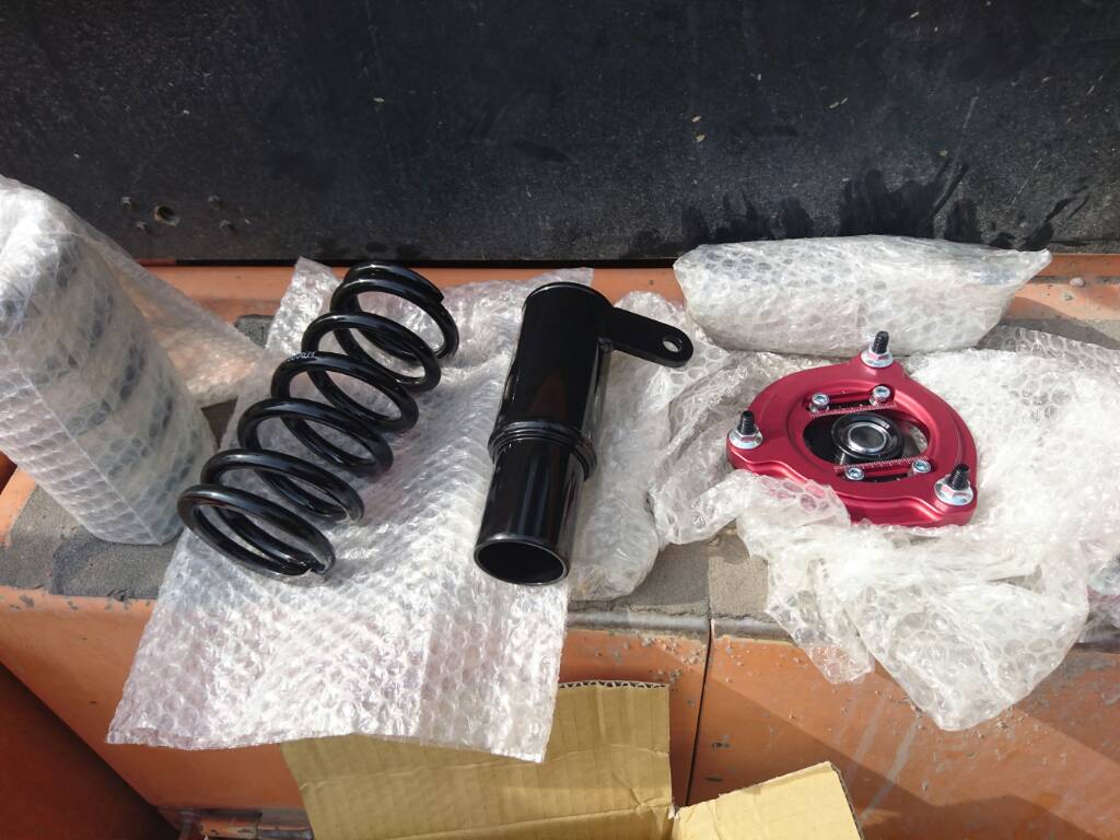

PM'd them and got a chance to participate in the test. In early April 2016 I received the coilovers to my 2010 MK6 GTI.
First impression were very good, I have seen all kinds of coilovers from the budget solutions to the expensive one. And this set is clearly aiming to compete in the expensive side of the game.
Started to install them onto the car but my phone battery died, so I'll edit this post as soon as I get my car lifted up and get those photos for you.
But, about the install. Removed the OEM coilovers and links, nothing special. Adjusted the new coilover's body to minimum and for my purposes, had to lower the spring adjuster to minimum so I can get the desired drop.
Coilover went in just as excpected and no problems were noticed. Adjusted the links to the right lenght so they wont rub into anything. Left the camber plate to factory setting, and had allignment done afterwards.
