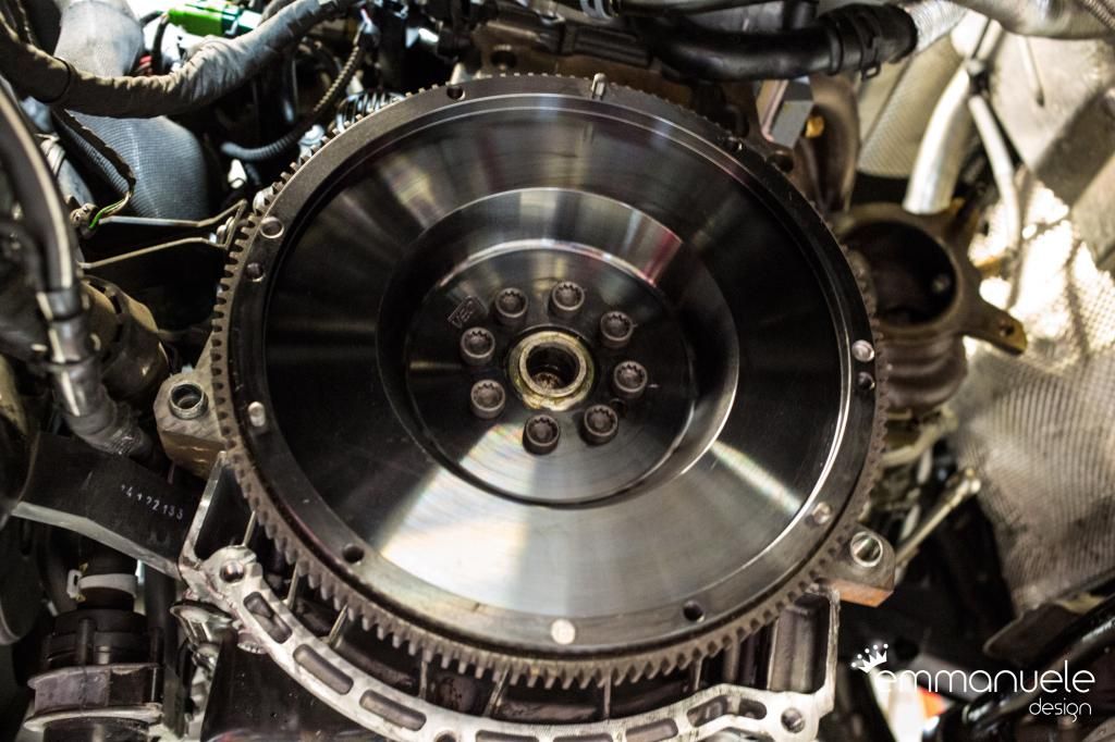

I noticed my clutch slip for the first time about 3 months ago, and I began my research. I would do some research, learn some stuff, and then sleep on it. I have no experience with aftermarket clutches, so I did this for a while trying to figure out exactly what I wanted to do. One of the hardest decision was to choose the dmfw or upgrade to a smfw. Eventually I landed on this clutch with the smfw. I wanted the benefits of the smfw, but was really worried about the additional NVH. Replacing the clutch is not cheap, so I wanted to make sure this was only something I'd have to do once, and I didn't want it to result in me hating the car.

I do like how the pedal feels though, and when I'm not doing a sloppy shift from not being used to the pedal feel/catch point yet, it feels amazing. You can definitely tell how the smfw changes the car. It's amazing how much that dmfw seems to jerk the car around. With the dmfw driving around parking lots and things like that in first gear used to feel pretty sloppy sometimes, the car would jerk forward. Now first gear feels so much smoother and easier to operate. Shifting from 1st to 2nd is still a little tricky, but the rest of the gears are easy to shift smoothly. Today I was shifting from 1st to 2nd smoother than I have been this week, so I'm getting there.
