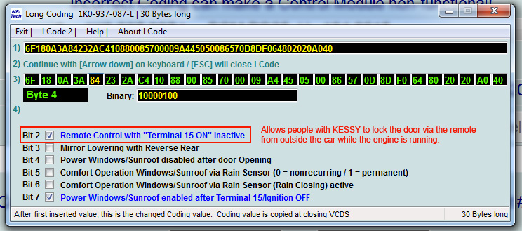

Made a nice little discovery while snooping around in VCDS to change a few things. Turns out that if you check Bit 2 under Byte 4 in Central Electronics, you can get out of your car with your key while it's running, just like normal, except that you can now lock and unlock your doors with the remote.
This is a nice feature for the northern climates in the winter when you want to start your car and let it run to warm up for a few minutes, but don't want to leave it running and unlocked.

did this today - very cool. Only possible "negative" is that you can't unlock the door with the "handle touch" like you normally can - ONLY after locking it when running tho, that normal function still works like usual, but when leaving the car running, closing the door, locking with the remote, you do have to use the remote to unlock it again. Not an issue for me, but just letting people know.
I am VERY happy now that I can lock my car when its running, since it would not let me do this before :w00t:
