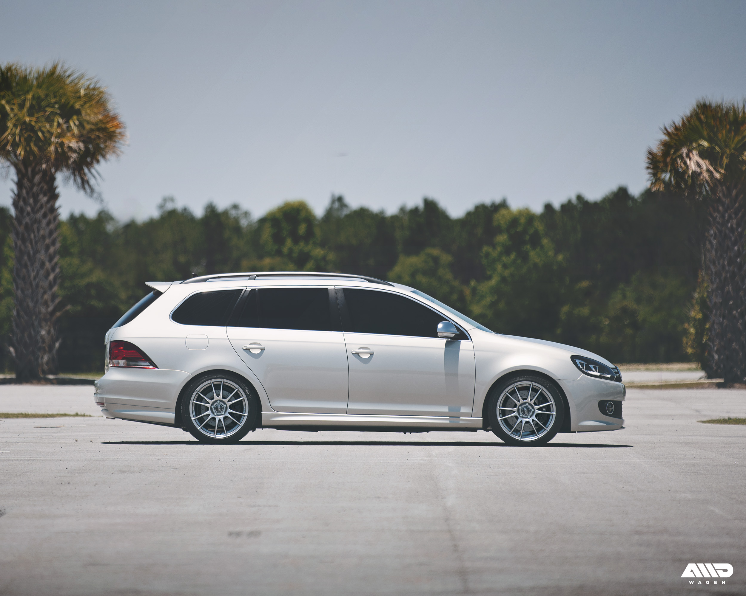

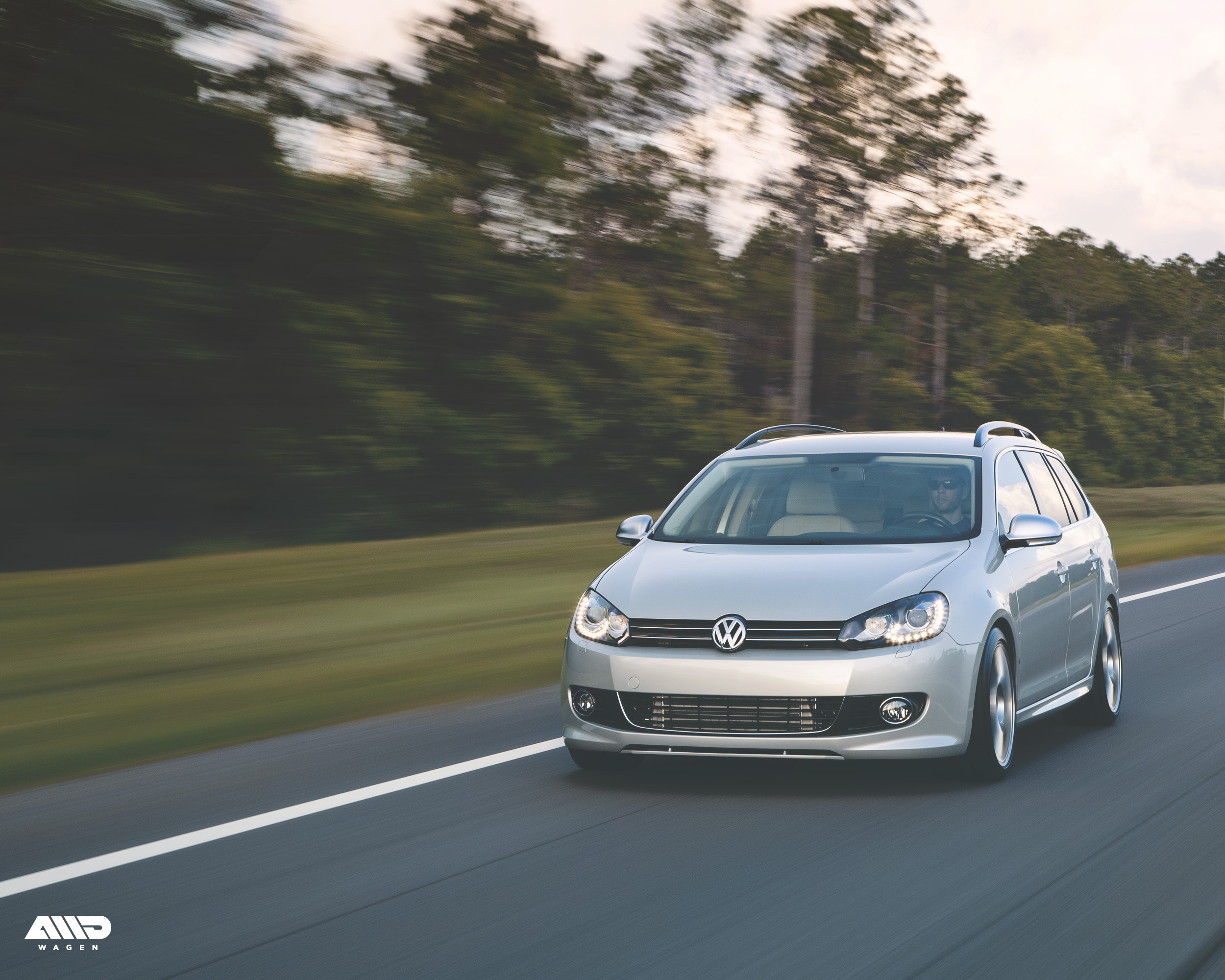

2011 Mk6 JSW SE2.5 with 4motion swap and a 5cylinder turbo.
![](/forums/proxy.php?image=http%3A%2F%2Fjoegodbee.com%2Fjsw%2Froller.jpg&hash=55d5d454d8660b30d4bfca851e0abca7)
![](/forums/proxy.php?image=http%3A%2F%2Fjoegodbee.com%2Fjsw%2Fawdwagen-side-ig.jpg&hash=8be7505af067ba549e7a0b687779da35)
