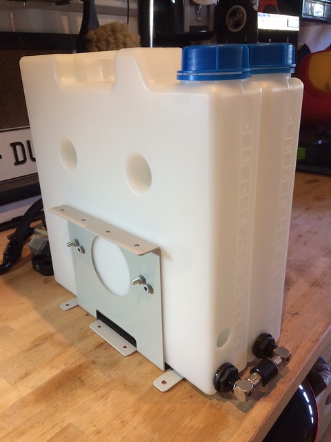

Aquamist 10L (2.6 Gallon) Baffled Tank Unboxing:

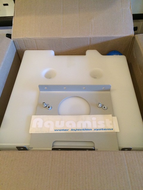

The Aquamist tank comes well packaged (photo below is after all packing paper was removed). I ordered my tank with a pre-drilled 22m hole for my Aquamist tank level sensor. I removed the two blue caps to peek inside the tank and I have to say, the baffle design is excellent. The twin tank outlet adapter is high quality with a swivel compression fitting for the 6mm line running to the pump inlet. The mounting bracket is completely reversible so the user can install on either side of the trunk.

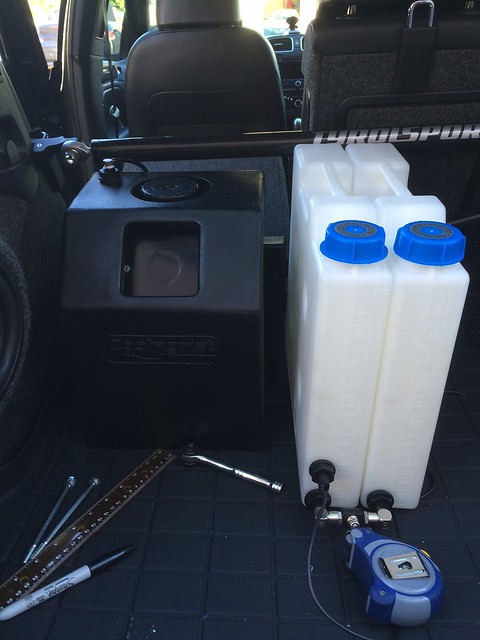

Aquamist 10L (2.6 Gallon) Baffled Tank Comparison:

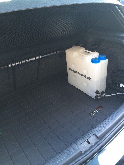

Compared to the previous 2.3 gallon tank I had, the new Aquamist tank takes up much less room against the inside of the trunk. This coupled with the fact that I can now visually spot check my fluid level makes it a great choice.
Aquamist 10L (2.6 Gallon) Baffled Tank Installation:

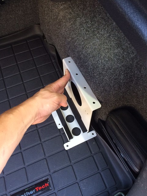

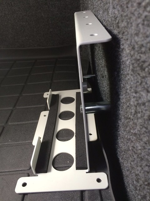

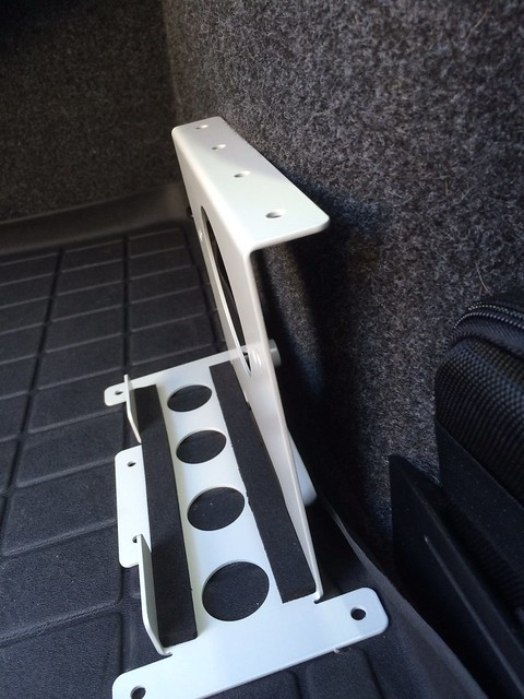

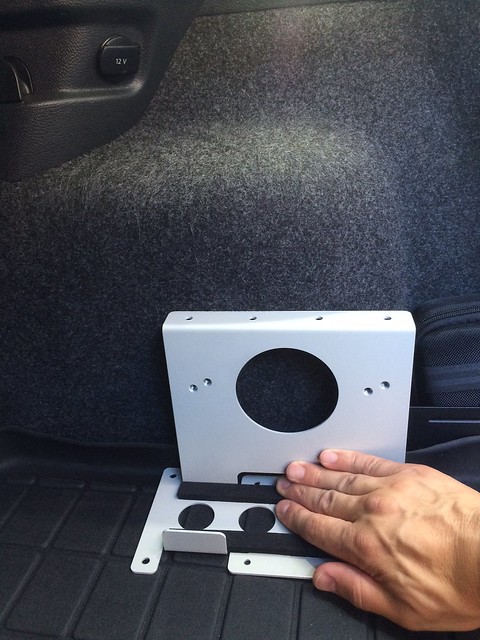

As mentioned before, the versatile mounting bracket is completely reversible so the user can install on either side of the trunk. After locating the mounting bracket so the tanks would sit against the back seat, I decided to use long hex bolts through the side of the mount and fender. Alternatively, you can bolt on an strip of wood (1" x 2") horizontally so the mounting bracket can be rail mounted. First, I measured several times to ensure I wouldn’t interfere with the fuel filler neck or EVAP lines behind the passenger side rear wheel. After drilling pilot holes, I enlarged the holes just enough for the hex bolts. Since the passenger side trunk wall is not flat due to the wheel well, I used various length spacers/collars (3/4" diameter) to keep the mounting bracket straight as the top of the mounting bracket (holes for cross-rail hanging/mounting) will sit flush against the inside of the trunk and may pull or bend the bracket slightly. The spacers/collars allowed me to tighten the hex bolts and nuts a decent amount without affecting the mounting bracket. From there, the twin tanks slide right into the mounting bracket and fasten with the included hex bolts. The next step was to connect the tank level sensor and the high quality swivel compression fitting for the 6mm line running to the pump inlet. The final step was to drill a 1mm hole in the center of each blue cap to prevent the pump from vapor lock. I believe in the near future Aquamist will be developing an integrated external vent solution.
Aquamist 10L (2.6 Gallon) Baffled Tank Overall Results and Recommendations:
Overall, I’m extremely that I can now maintain almost all of my trunk space while having 2.6 gallons of water methanol at the same time. Thanks to the internal baffling, it utilizes the full capacity more effective compared to a non-baffled tank. I have not had any false low level alerts while driving hard or during uphill/downhill transitions. If anyone is looking for an extremely high quality tank option which doesn’t eat up a lot of trunk space, I highly recommend this tank.
