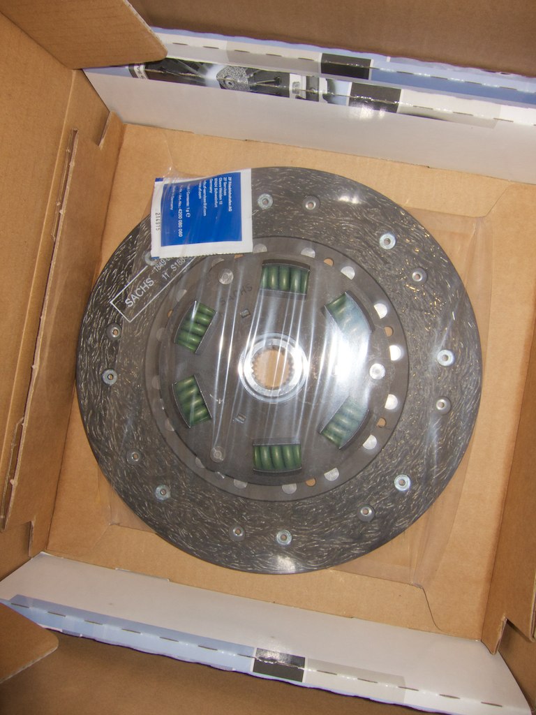

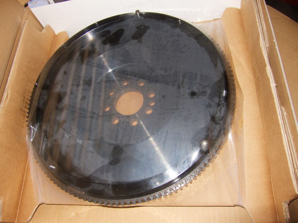

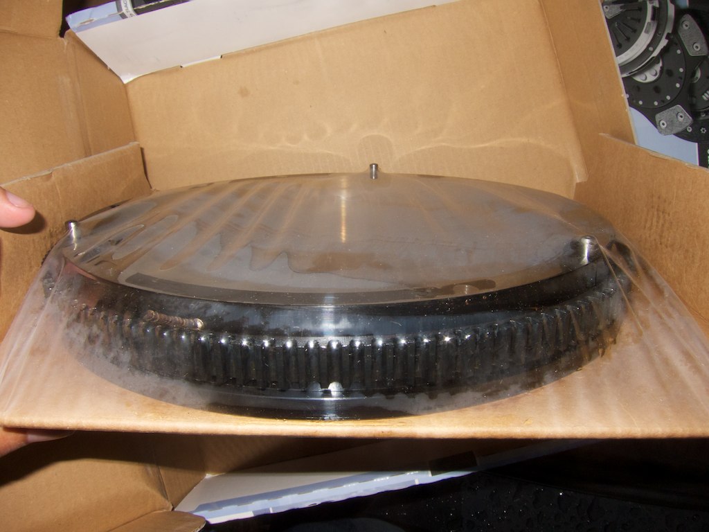

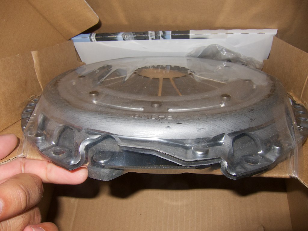

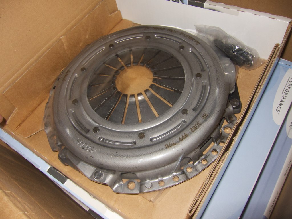

I went for the SRE kit with the organic disk and the single mass steel flywheel
Photos of the stock clutch as well as the uprated one will follow. The springs on the stock disk when compared to the ones on the SRE disk are laughable.

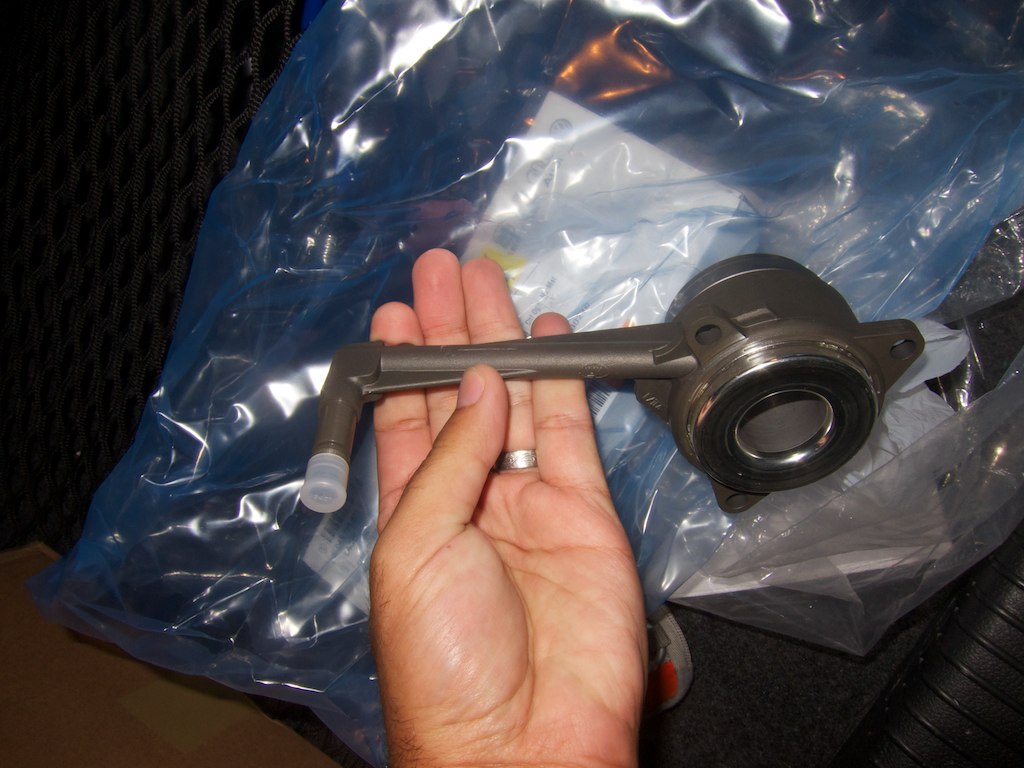

A new TOB was also installed since my 2 piece plastic one was squealing like a train, very disheartening on a 40thousand dollar car( Canada Eh!).

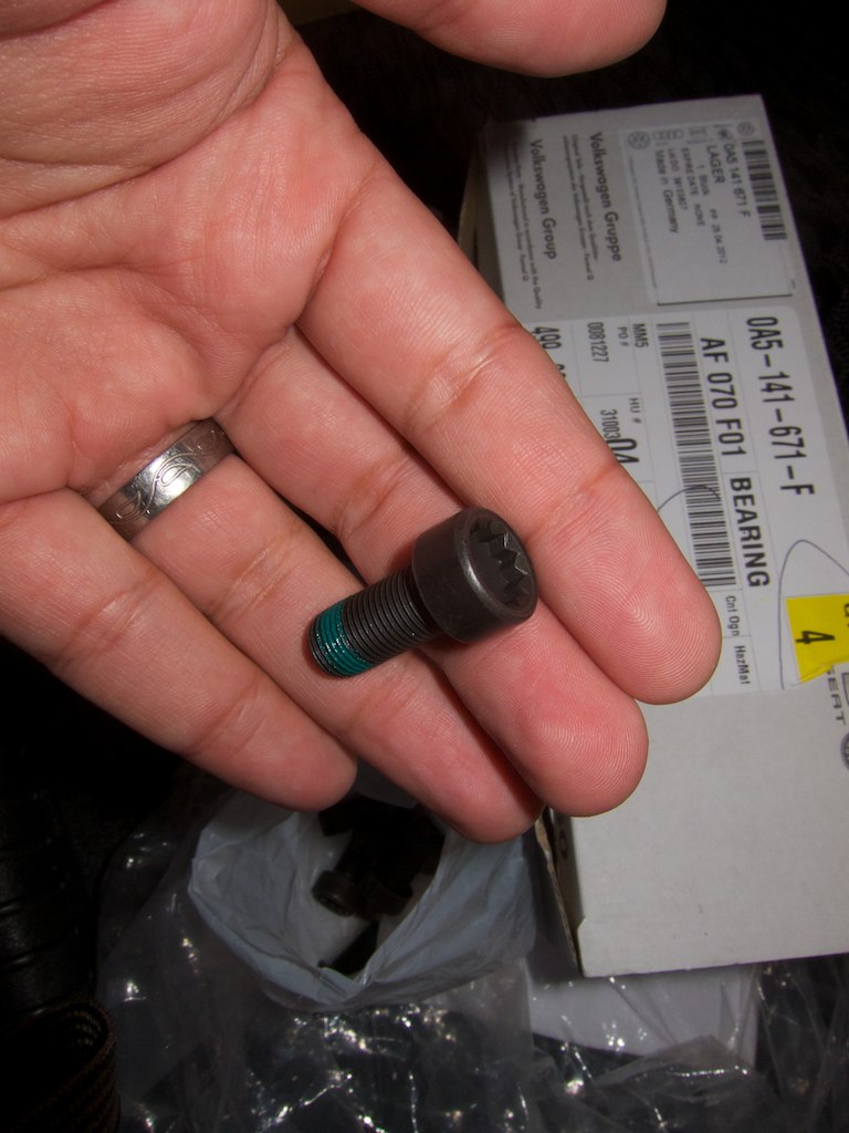

And some pictures of what went in:
IMG_4430 by tudorior, on Flickr
IMG_4431 by tudorior, on Flickr
IMG_4435 by tudorior, on Flickr
IMG_4436 by tudorior, on Flickr
IMG_4439 by tudorior, on Flickr
IMG_4442 by tudorior, on Flickr
IMG_4444 by tudorior, on Flickr
IMG_4445 by tudorior, on Flickr
