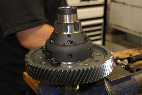

I’m not going to head into the details here or the mechanics behind an LSD but rather review the unit I chose and how I feel it changes the characteristics of my vehicle. I considered three LSD units, Peloquin, Quaife and the latest Wavetrac release. Peloquin has been around for a long time, is a one man shop here in the US, and has been noted across many Audi/VW forums. The Quaife unit has also had nearly the same amount of positive feedback. The Wavetrac unit has some amazing patented benefits, a great comparison to the first two units but has not been proven long term yet. After talking with Peloquin (Gary) over the phone and reading countless threads I decided to go with a high quality unit which has been proven time and time again. If you read the history section on his website, it’s clear why he’s been in business so long. The shipment included the LSD unit, bearings, ARP bolts and shims. The LSD is truly a work of art, heavy as hell and a clean piece of mechanical magic. I almost felt bad installing it in my car, as though it deserved to be in a glass encased pedestal in my man cave. The shipping was fast and packaging was top notch.

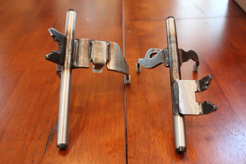

Shift Forks:

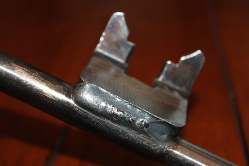

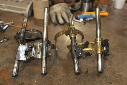

Hearing how some of the high mileage MK4’s and MK5’s had brass shift fork failures, I wanted to upgrade to the USP Motorsports 1st-2nd & 3rd-4th steel shift forks while swapping out the supposed “lifetime” VW transmission fluid for Motul Gear 300 SAE 75W90 transmission fluid. From what I’ve read and seen in person, the weak brass forks experience broken claws and are held together with rivets vs. welds. I wanted to upgrade them and resolve the potential problem ahead of time. These steel shift forks are an upgrade to the brass failure points and the problematic riveted assembly by way of a more durable welding process.

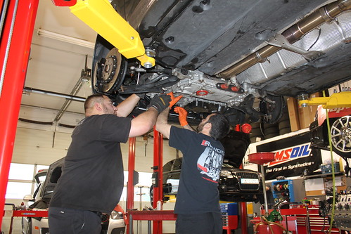

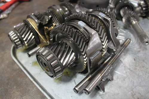

The LSD + installation is a heavy bill to swallow all in one shot. Luckily, Redline Speed Worx (RSW) has recently started offering GE CarCareOne 0% interest financing options (lifesaver near the holidays). JR at RSW has done countless transmission rebuilds and LSD installations. Before starting he laid out all the parts and required tools for an organized installation. He drained and removed the transmission, opened the transmission case, cleaned all components and transmission case in a special enclosed wash tub, visually inspected the internals, disassembled the current OEM differential, assembled the new Peloquin limited slip differential, reassembled the internals with the addition of the USP steel shift forks, sealed the transmission case, re-installed and filled the transmission with Motul Gear 300 SAE 75W90 transmission fluid and bled the clutch line with fresh ATE Super Blue 4.1 brake fluid. Overall the installation ran the full day but it was reassuring to see that JR and Redline Speed Worx spent the time to visually inspect and wash the internals in a solution so everything was re-assembled with care. A part of me feels like I received a freshly rebuilt transmission.
The End Result:
After JR bolted everything back together he took me for a test drive to explain the dynamics and what to expect. He flipped ESP off and pulled out of the shop and into the rain. He tried to break the tires loose but even with snow tires in the rain, we experienced gobs of traction. Leaving the shop I kept ESP off and drove easy on the way home. Immediately the transmission seemed smoother with less noise and shifting was also much smoother, most likely a result of the fresh Motul transmission fluid. The USP Steel Shift Forks did not change the feel/weight/engagement of the transmission, one would be hard pressed to notice a difference. It’s just good to know this preventative step could save me from higher repair costs down the road. On a few side roads I moderately tested straight acceleration from a stop (with my new axles I won’t try full WOT holeshot launches). Wheel hop was gone, torque steer compensation held fine at the factory setting without any increased intervention from the ECU. The steering wheel feels tight and settled during acceleration through a straight away or turn. Around tight turns you can feel the front inner tire gripping and clawing away. Between this Peloquin LSD and certain upgraded mounts it feels like this car can apply close to 100% of its drivetrain power to the ground, making it feel even faster. Since owning this car, I have never wished for snow, but now I can’t wait to romp around to see how it reacts!

Shift Forks:
